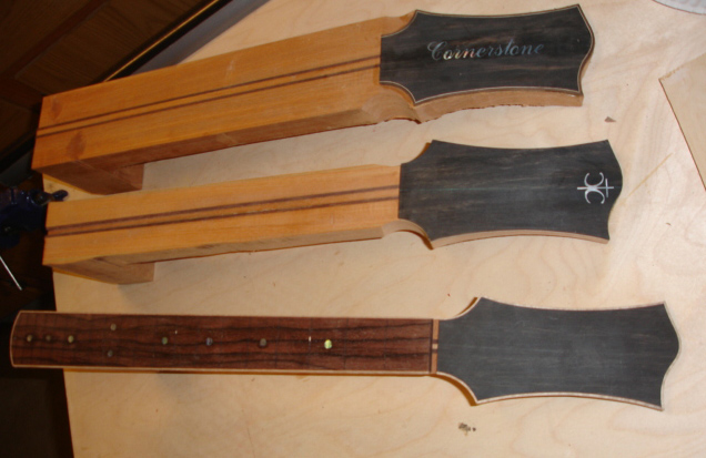

I am trying to remeber, what shape is your headstock? Can you post a picture for us? I think that would help to see what your are up against. Sounds like it is plenty thin, but maybe a few thousands less would be the secret? I don't know, but there must be a way to make it work. Walk away for a bit, that always helps me.
Jeff
PostPosted: Sat Jun 10, 2006 4:16 pm
Here's some headstocks....

Peter,
It might be easier doing 5 pieces with mitred joints - top, 2 sides and 2 bottom curves that meet the nut.
Or 3 pieces - 2 for the sides and one for the top.Dave White38879.247025463

Tony....it might be a good idea to make a small mold for the headstock. I did bend the bindings on my bender for the body and it bent pretty well even with a very tight waist.
I do bend the headstock in 5 segments and then mitre then aglue them on the headstock.
